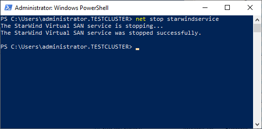

1. Stop the StarWind service.

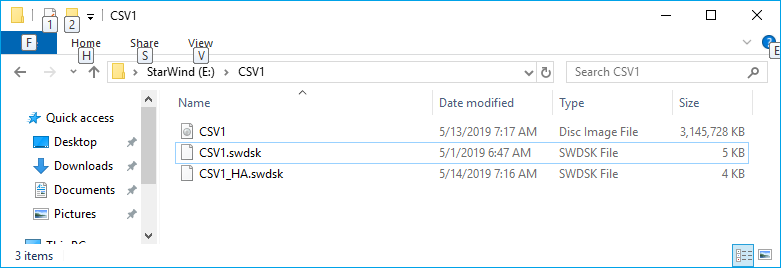

2. Open the folder containing the *.swdsk StarWind device header file(s):
3. These are the lines to be removed from *.swdsk device header file(s):

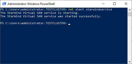

5. Start the StarWind service.
Wait for synchronization to complete, then repeat the same steps on the other node(s).

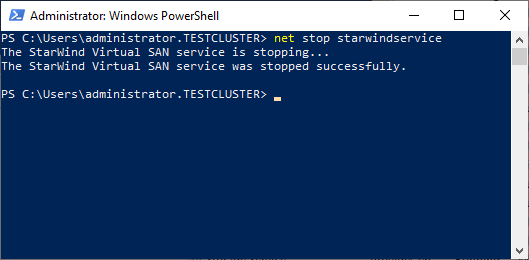

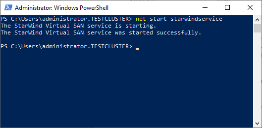

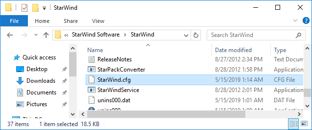

Instructions for devices originally created in StarWind VSAN 6.*
Disabling cache

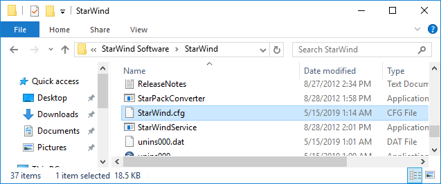

2. Open folder where the StarWind.cfg file is located:
3. Search for entries for HA devices in StarWind.cfg like the one below :
4. Change CacheMode=”wt” to CacheMode=”none”:
5. Save the StarWind.cfg file.
6. Start the StarWind service.
Wait for synchronization to complete, then repeat the same on the other node

Changing cache size
4. Change CacheSizeMB=”512″ to CacheSizeMB=”{value}” where {value} is the required L1 cache size:
